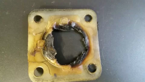

Just cleared the jam again and ran a light through the vertical shaft. No block there after clearing, but just noticed the gasket on the bottom auger. I never realized it but it's pretty messed up and must have something to do with it. I attached a picture of the gasket. Top one is fine. I'll need to order a new one somewhere, hopefully local so I can get this up and running again.
Surprised as the lower auger would constantly turn while the upper keeps jamming.

did you loose power before this started happening? or have smoke back? "hopper fire"
No power loss, smoke back or hopper fire. This gasket has been like this for a while. I just really never paid enough attention to that. I purchased this used about 6 years ago, but it has run pretty well until recently. I have a new gasket on order. Will see if that's the problem.
Mode D is the factory setting for the pdvc.
It may help it burn better but that gasket shouldnt be causing any jams
