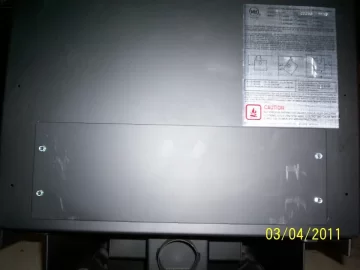

Brother Bart, if I may...
This is a pic of the rear of the stove. Where you see the 4 screws that hold that rectangular piece of metal onto the rear heat shield, is what you would remove, and install the fan unit on to; the heat shield that is.

That's the place.
If you want to get an idea how the blower will do, just lay a fan on its back aimed up between the heat shield and the stove body. Not touching the stove of course. But it will give you an idea of the airflow over the top of the stove.
