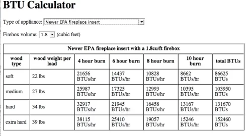

In terms of burn time and output, please see the attached chart which a fellow forum member and I are working on. This gives the approx. output of that unit over various burn times.
In general, you should consider outputs of less than 12-15,000 BTU difficult to attain (so even though chart lists potential longer burns at low outputs, they are not always easy to do).

Firebox on that is only 10% bigger, so just increase the figures about by 10%.
