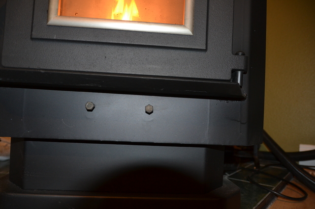

  16. Thaddius Wenderoth
    Thaddius Wenderoth
    Feeling the Heat 2.
    Jan 21, 2013
    249
    76
    My bad! I was thinking of my PDVC.

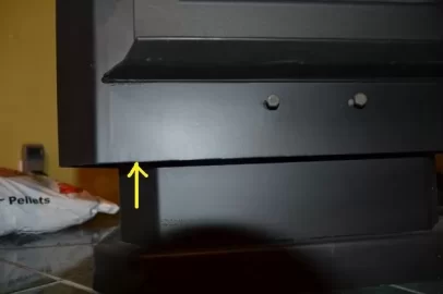

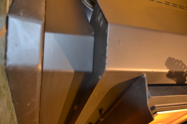

  17. Panhandler
    Panhandler
    Aug 24, 2008
    606
    12
    WV Northern Panhandle
    PDVCs have 'em,too. Underneath bottom lip just under left edge of door and under hinges.

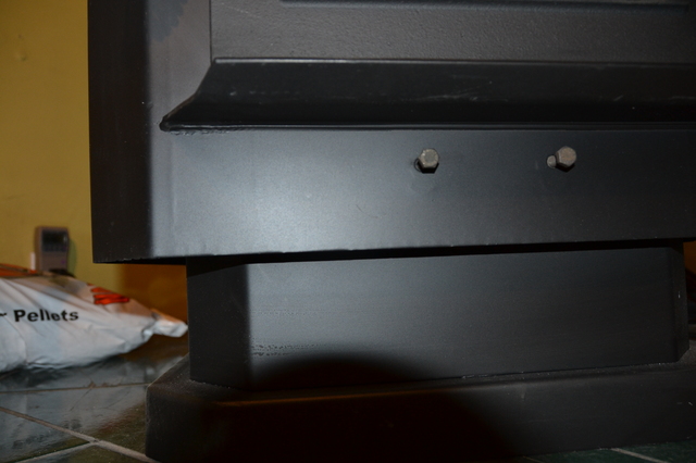

  18. Thaddius Wenderoth
    Thaddius Wenderoth
    Feeling the Heat 2.
    Jan 21, 2013
    249
    76
    Looking for it...
    [​IMG][​IMG][​IMG][​IMG]
  19. stoveguy2esw
    stoveguy2esw
    Nov 14, 2006
    6,186
    1,102
    madison hgts. va
    look under here, on both sides
    DexterDay likes this.
  20. Thaddius Wenderoth
    Thaddius Wenderoth
    Feeling the Heat 2.
    Jan 21, 2013
    249
    76
    Tada! Thanks Mike!
    [​IMG]

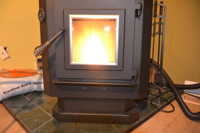

  21. stoveguy2esw
    stoveguy2esw
    Nov 14, 2006
    6,186
    1,102
    madison hgts. va
    no prob, BTW your floor protection is not to code, right side is too close to the edge by my eye.;)
  22. Thaddius Wenderoth
    Thaddius Wenderoth
    Feeling the Heat 2.
    Jan 21, 2013
    249
    76
    Working on it. If there were a better selection of double wall pipe in my area I would be a lot better off. That pad was there for my wood stove and I was unable to get the pellet stove to line up with the chimney in the ceiling with out being off center like that. Thanks for the heads up!
