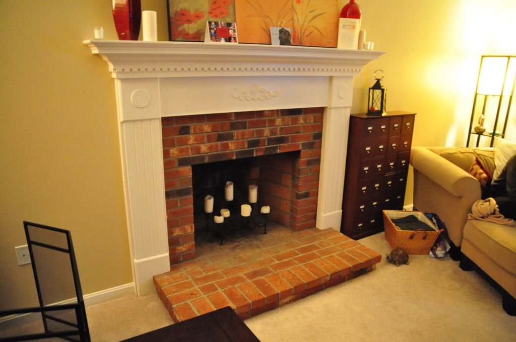

Actually, it is possible the photo is deceiving, the hearth is 24 inches wide outside of the fireplace. I just checked the Jotul F55 out and it requires a 40" hearth. Similar issue with Enviro. So unless we put the freestander in the fireplace, it seems most wouldn't meet the specs.
Fireview? :)
Should I be concerned about over-heating the bump-out room with a larger stove...or is that unlikely?
No, you don't need to burn full stove loads of wood if the temps outside are milder. And the fan trick I mentioned really works at both tempering the stove room and convecting the heat to the rest of the house.

I was going to jump,in here and recomend the VC montpelier but I don't think the fire place is wide enough at 24" We really like ours.
That's a really nice looking stove. It would actually fit, the hearth depth is 24" but the fireplace opening width is 35", so it looks like it'd fit. We like the stoves that stick out a bit so we can throw a kettle of water on there to keep the air from drying out too badly, again though, that's a nice looking stove. I'll have my wife check it out when she's at the local dealer today. Though, I've read some discouraging things about VC in my searching, so that brand isn't at the top of our list.

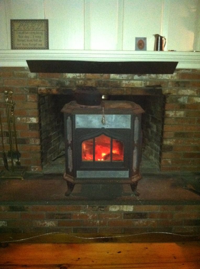

LOL, sorry, I meant, can you fit a Fireview (Woodstock)?
See mine here. It's a side loader so front clearances are low...

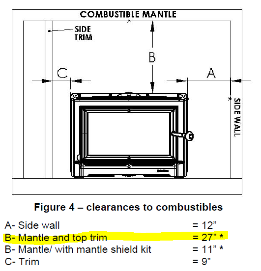

Question, I was checking out the clearances for the Clydesdale, in the image here is "B" the distance to that first piece of wood trim on my mantle (which is 2" thick), or the distance to the top shelf of the mantle?
[Hearth.com] Enough stove for the job?
That's going to be the Closest combustible surface, whether it be trim or actual mantle.
Yup, but a mantel shield will be your friend. You can see mine in the pic I posted - it is not very pretty but I had a machine shop make it for me - you can definitely get a nicer designed one.
And the mantel shield doesn't need to be up under the mantel. It can be at the insert level, starting at the surround. That's definitely where I would put it in this situation.

Click on the diagram for the full size image. I'm reading 24" to the mantel and top trim in the Clydesdale manual. I think the shield would need to project from the surround 1" past where 24" hits the mantel molding.
The Jotul C450 manual is located here: (broken link removed to http://www.jotul.com/en-us/wwwjotulus/Main-menu/Technical-documentation/)
