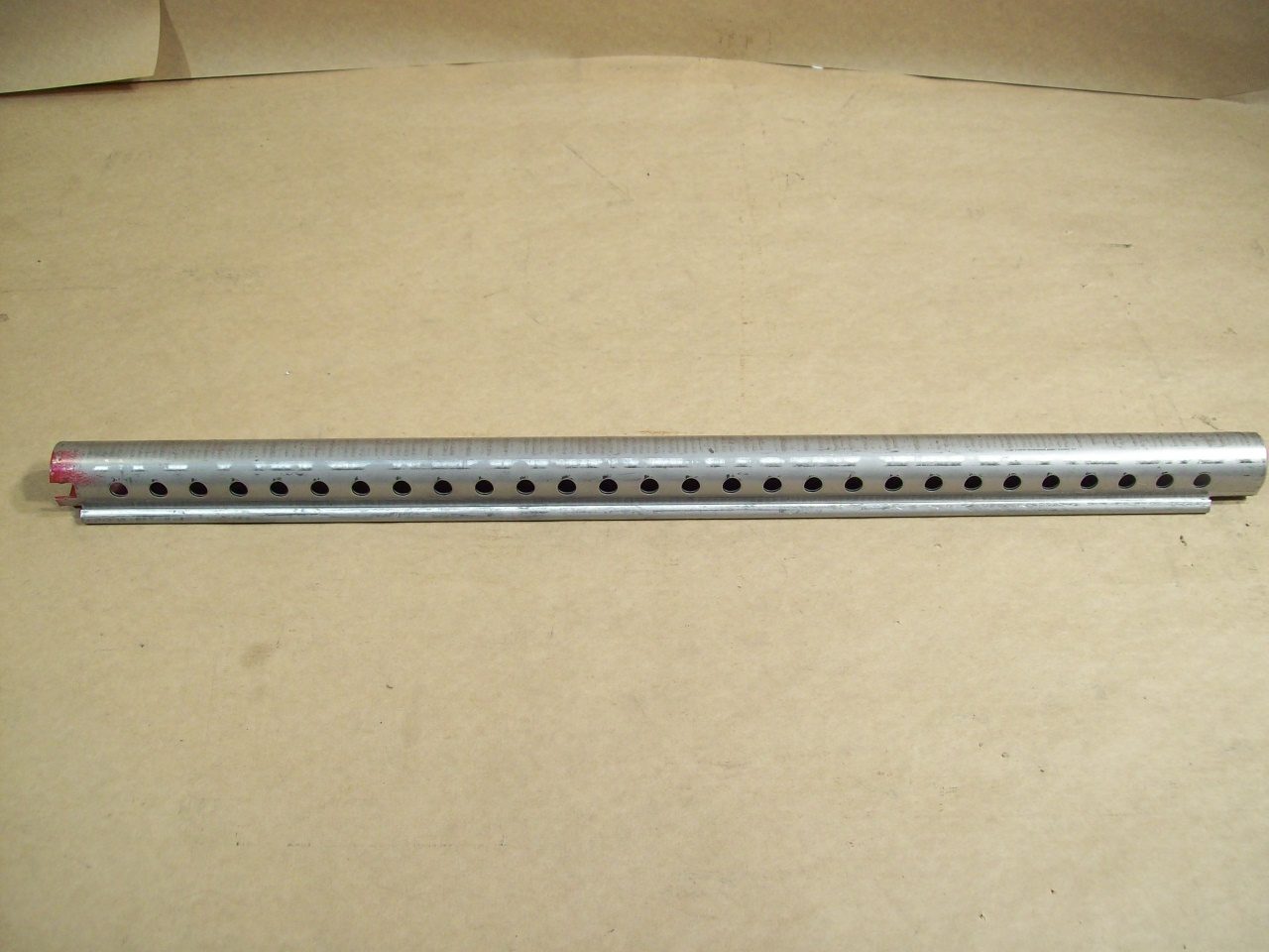

I‘ve bought an extra baffle and ceramic flue gasket to keep in stock.
But, I am now wondering how long the 4 secondary air tubes life span usually is and if I should grab an extra set to have just in case. They are not cheap, that’s for sure!
Also, thinking about getting an extra fan assembly.
I’ve had this stove since 2012. It’s been running awesome all these years. Hope we never have to replace it.
The Enviro Boston is an excellent heater and a very good looking too. As long as it is maintained and not overfired, it should last decades. It's a real shame Sherwood decided to discontinue selling wood stoves.
Unlike the mild steel tubes of the past, stainless steel tubes last a long time. If the stove is not overfired they may last 20 yrs. or more. Note that each tube is different.
Good to know these air tubes should last over 20 years…. Although, I am on year 12 with them.
Burning conditions vary so much that it's hard to predict lifespan. We're on season 15 with our PE T6 and the baffle still looks good. We've had some here with the same baffle after 25+ yrs. Others have had to replace them due to warping after 8-10 yrs. I strongly suspect the difference is in how hot the stove is run. Both Enviro and PE stoves are easy breathing. When put on a tall flue system >25', the stoves can run hot unless the draft is dampered. Unfortunately, most stove manuals do not cover this situation.
