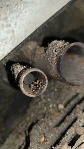

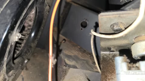

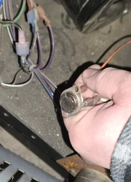

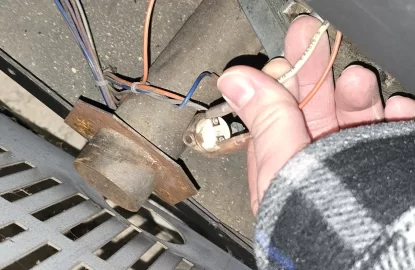

I am tired of having to manually light the pellet stove and would like the igniter to work as intended, it does not turn orange or seem to heat up at all. I've done some research on parts and purchased an igniter off of amazon, the 50-1067 model number. I started to pull apart the pellet stove to get to the back of where the igniter sits. after moving the blower out of the way i was able to get the t20 screws loose holding the igniter. When I finally unscrewed what i thought was the back of the igniter, it looks like it detached from the actual stick part of it???

That is not your ignitor that is your Exhaust Temperature snap switch. Ignitor should look like below picture and is located behind your auger motor. Watch video not your exact stove but most enviro's ignitors are in the same place.
[Hearth.com] enviro ef3 bay i - igniter issues
AS ARC said, not your stove, the placement is the same as yours
have to remove the auger motor for easier access

How old is your stove ?the early models like mine 1997 ish had a pin type igniter which pull out from the front of the stove (where the burn pot is ) it has 2 pins on the end that plug into a socket inside the stove
