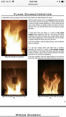

mine looks just like Bill's after two weeks. I'm new to pellet stoves this year as well, but I would add more air for sure. I bought a manometer on ebay for $30 bucks just to ease my mind on draft. A lot of people here have said that the installer didn't set it right. high for an hour then check. Just a thought but maybe get rid of the log and see what happens. looks like a pain to clean anyway. You can see in the ash pan on mine and see if there is a lot of glowing pellets. 1/8 " increments on the damper adjustments changed readings. I also bought a corn cleaner on ebay from a guy in Wisconsin. I hope he makes a million bucks on it because it"s awesome. Didn"t want that sawdust in my stove and I mix corn with pellets. The pellets I am using have maybe enough dust to fill the palm of my hand. It also makes it easier to put pellets into a 5 gal bucket. 2 buckets per bag. Easier to dump pellets in with bucket. FYI home depot bucket is taller than a lowes bucket.

Ian, you are probably closer to a good damper position than I thought at first, but I agree with everyone that you could open it a bit more. Take a look at the picture Ssyko posted--I found it more helpful than those videos you mention.
