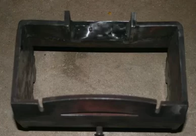

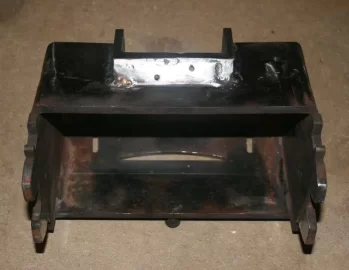

Wings so it could fly? No,No, No- Its cause I'm a jay"bird"- all my stuff gets em. :-) Wings, well more like extensions were added when I was burning corn. Corn is smaller than pellets so I loist alot of them on fresh starts. Dumped a crap load in the ash pan.
I have seen the M55 and it's burnpot is set farther back into the stove, Closer to the drop chute. SO they don't loose as much as the Omega does there. But they still loose plenty over the side of the burnpot liner on start up. There is a thread here some where! I assumed they also moved the burnpot farther back on the Maxx M. But I haven't seen one to compare yrt.
edwinjk, Can you post some pictures? I need to see how far away from the back your burnpot is. I'll post some pictures of my wings.
To get around this, Before I made my mods. I would pack ash on both sides of the burnpot liner to keep the pellets in when starting. This will keep pellets in and you only need to do it on start ups after cleanings. You still might loose some over the back, Depending on how far it is from the back of the stove.

Here's a couple pict's of the modded burn grate. These were taken right after welding. The ears on the bottom that hang into the burnpot liner did the most at keeping the pellets in the burnpot. But they are degrading now and need replacing. I'm starting to get more pellets in the ash pan. So I plan on remaking them from stainless steel. And just bolt them to the side of the burn grate.
Once I make the templet, I'll share it with you.
If I can find the pictures of the proto type. I'll post them too.
