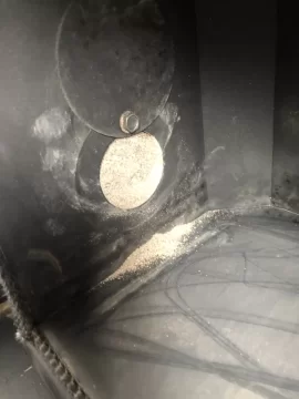

Did a deep clean. That’s what I found. Stove was installed on January 25 this year and the installer told me that I only had to clean that out once a year. Haha

Bingo
Now that's what we were talking about
Burns better now?
Necessary evil on pellet stoves. Ash must be removed.;)
Was the installer also the one who sold you the stove? He is / was FOS.
