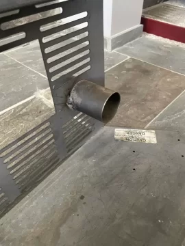

Thanks and I have the outside air kit attached to the back of the stove. The pipe it attaches to only goes about 2” into the stove and then there’s about a 10” gap between that and the stove port. All opened to the floor and the air in the room. Nothing connects the 2

I take it you welded the pipe to the cover
Your air kit should go into the back of the
stove and a 2 1/4 outside dia pipe slides into
the hole by the igniter. There is no physical
attachment just a pressure fit so that the OAK
can be removed so that the back cover can be removed
There is no need for a physical attachment

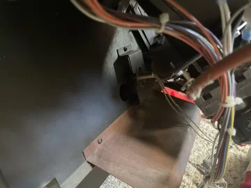

OK thanks not it was welded when I got it. The hole by the igniter is about 1 1/4 +/- so I will need to find something to fit and then some adapter to get it all setup. thanks
Thanks again and this is what I currently have no way of connecting. All I have is the hole for the air intake. Thinking of just finding a pipe that would fit and rigging something up if I can't find the right part.
[Hearth.com] Enviro Windsor air intake
I'd use and have used automotive exhaust pipe of the proper outside dia.
Just slide it in about an inch. loose fit is OK after all it is an air intake
not under any pressure
