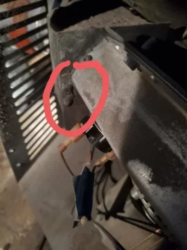

So after another full cleaning, I ran the stove with both sides off in back. Noticed after about 10 minutes hit sparks coming out left side twice.
Then noticed that the metal exhaust piece that the exhaust blower attaches to has some crappy welding on it that is leaking. Part is obsolete unfortunately.
The stove was purchased 4 years ago as a demo model from deans stoves and should never have been sold like it was. Going to stop in today and see what they say about it. Darn lucky my house didn't burn down....
can you show us a pic :)
Here you go

This stove has been out of production since 2006 I think, and replaced/updated by the Empress, surprised you could buy a demo. Most stoves have a pretty rudimentary exhaust manifold that end up with a lil extra Hi temp sealant. I'd remove the combustion blower, clean and reseal. Also on my convection fan (Fasco #702110550 -2550 RPM), I actually added a dial in series and dialled it down a little and put on a higher temp snap switch for the factory controlled variable fan system which kicks it on Hi when you hit 160*F, I changed it to 180*F -20* variation. this stove does a great job of radiating heat with all those cast panels, I actually like running the stove with convection fans off but then it kicks on hi every 20-30mins for 10-15 min until the temp drops. The stove works better radiating heat than running the fans on Hi I found in an open concept. Again you will have hard time to finding a stove that looks and works this nice, so you would be best to seal it up and make it through this season. I also ran OAK and added 2" flex exhaust pipe behind the cabinet right to the burn pot intake pipe, this helped in a sealed newer home.

Pretty nasty back there, time to clean it. A bit of JB weld or some torch work would handle it quite nicely.
