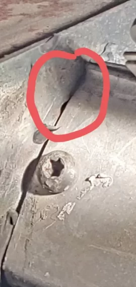

And another hole lol

looks like the sealant just gave up and fell off. Damn Steevo i would have to clean that thing up and seal it and go another 10 yrs.. you can't beat them old stoves.
Certainly is filthy in the backend. Wonder if he lets his car get that filthy inside?
I am going to reseal it up and see if it works right now.
Not sure if the entire exhaust piece comes out with fan ( thenni can have it welded correctly..... manual doesn't show much on it

Can't tell by the picture, if that was originally welded ? Sure seal it up with high temp sealant good and tight see what happens..
So far so good after resealing it. Going to see tomorrow if I can remove the entire exhaust from fire box or if its welded in place.

Glad you got it cleaned up, it is welded in place if I recall correctly.. Not sure whats up with SidecarFlip this year, he's been around a lil to long and might be losing it even more than usual.
So running the stove again today ( still dont trust it 100% when not home or at night when sleeping yet) running good, did some cleaning in the garage and found a role of header exhaust wrap. Wrapped the entire piece with it, put side back on..... seems to be running good.

I wouldn't wrap even exhaust header material around the manifold personally, a bit hillbilly, I would use HI temp RTV sealant on all corners, motor, snap disc, and cracks like they do from factory, also check the draft slider it also has a few open areas a spark could sneak out and get blown through the convection system. Try the convection fan blower number i mentioned, you shouldn't need a ton of CFM for this its just to push a bit of heat out the exchanger, and your fan should be variable and adjustable.
i wrapped it in the exhaust wrap as its white in color. just to see if anything sparked againt it. not there permanantly.... i sealed everything up with copper rtv ( 750 degrees )..... ill remove the wrap in a day or 2 to see.

sparks were coming out of the exhaust pipe right after the fan. there was a 2 holes as seen in the pics. I actually saw it happen.....
but hey by all means..... im open to all ideas on where it could be coming from.
