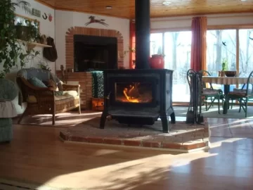

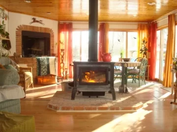

Installed Equinox last January. It is our first oven. We are extremely pleased with it. It provides plenty of heat (We have 2800 sq ft, 2 stories) and the look of the oven on a cold night is most relaxing. We decided for the softer heat and the ambience of the Equinox. I don't know your positioning of the oven, but, as you can see we put
ours in the middle of the room. The rear soapstone keeps our doorwalled area extremely cozy despite the ceramic floor and all the glass. We looked at different models and are very happy with our choice.
