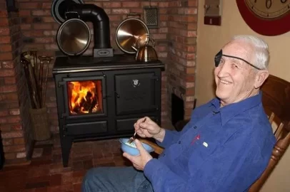

PS- here is a recent picture from another customer enjoying a dish of ice cream in-front of their new Ironheart. One of my favorite pictures that have been sent in so far.
