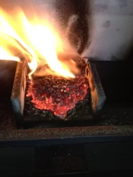

Watching this closely as my refirb/ new 25PDV is doing almost exactly the same thing. I also have burned just about as many bags as you have as well Guitsboy.
Any setting mine backs up like this. This was cleaned out this morning at 6am....8 hours later and it is backed up. Running on Heat setting of 4 & a Fan speed of 9.
Is this about how your burn pot looks Guitsboy?

That's exactly how my PDV looks after about that much burning. After reading on here, it seems normal. I just have a metal spatula by the stove and once a day or so, scoop the ash into the ash pans on the side. I may eventually try a gasket under the burn plate to see if that helps.
