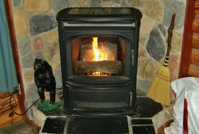

The rough, cloudy area (etching) is located just above the flame in this picture, of course on the inside of the door. I have NEVER used ANY cleaner on my glass. Just water. Did the first full clean of the stove this morning since new. Before emptying the ash pan I wetted a paper towel and dipped it in the ashes and attempted to gently scrub the area and this is what I was left with. Its as if it was sandblasted. Using same pellets used for the last 20 years.

I’d be contacting the dealer that sold it to you

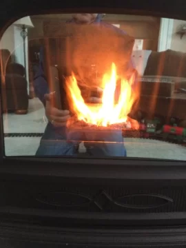

I know what fire looks like and I know the glass will soot up in a day or so of use, the soot doesn't hurt it. Not like I'm gonna leave it on there forever.
