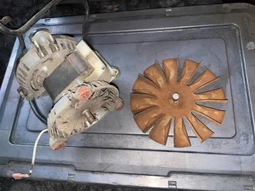

This Jakel Inc Combustion Blower is at least 20 years old in this Harman XXV and the bearing just started screaching in the middle of the night!
So out with the old and in with the new.
Also some cleaning and lubing to prevent rusting and galling!

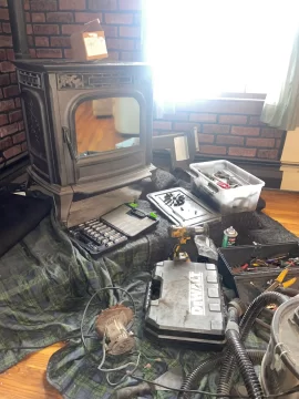

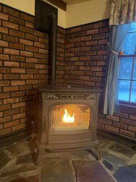

Pic 1 - Harman XXV

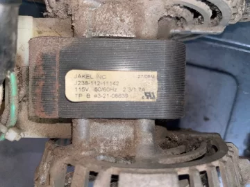

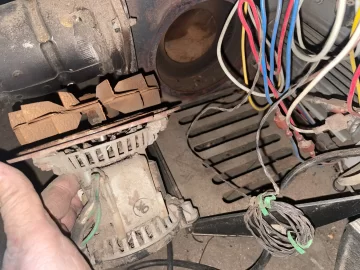

Pic 2&3 - old Jakel with double paddle impeller
Pic 4 - Only way to reuse the mounting plate is to cut the shaft!

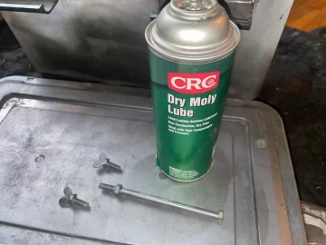

Pic 5 - Wire wheel the bolts clean and spray lube them with dry moly.

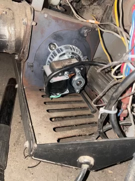

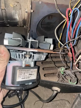

Pic 6&7 - New Gleason Avery combustion blower and double paddle impeller lubed with dry moly spray on mounting plate & blades

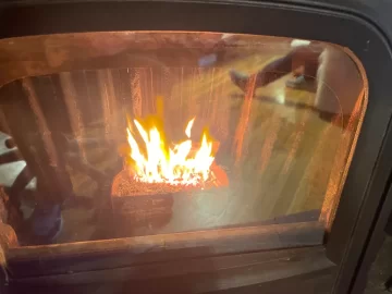

Pic 8&9 - XXV fires and runs quiet again!
