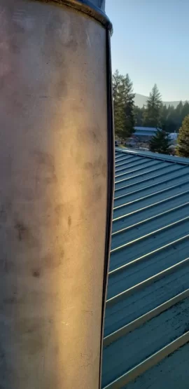

2 month ago I installed a new stove and new Duravent. Been burning for 3 weeks Straight. Very little downtime. Last night I had her die out and today I wanted to clean it, sweep the chimney, and well.. a propane day.
Anyways. Notice the seam on my upper 24" class A pipe separating. It may have occurred from simply removing the chimney cap. I don't have any receipts. But its only 2 months old. I'll call Monday. I highly doubt the local store will help either. This was their last year selling chimney parts. Too many hassles??
Anyways anyone ever deal with them? Is my issue even a big deal? Considered putting a 12" hose clamp but want to go the right way first.
Thx

It needs to be replaced. That will allow water into the insulation.
Dang why diddnt I think of that! That too! It won't raining for about a week or more..
. Luckily its only $100 but I have a feeling Duravent will help here. Their website claims to have limited lifetime warranty.....if installed professionally...we'll see. But I'm sure it easy to agree its some type of detect in the manufacturing.

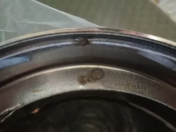

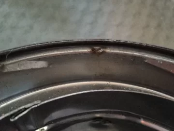

That pipe uses a crimped seam not welded at all
old vs new? This is a slip section.
¯\_(ツ)_/¯
View attachment 268642View attachment 268643
Oh there the better manufacturers don't weld anything there. Or if they do it is only tacked on one end. They also don't have solid heads there. They want the inner and outer sleeves to move independently. That is why we see less buckling on the higher end stuff. Jeremiah's that we are using now has no head or base. The inner and outer walls are totally seperate.
I was referring to the seam running the length of the pipe which is what separated here. Better pipe has a welded seam there
