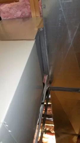

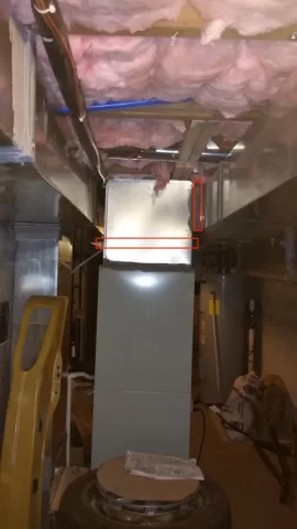

Hello Everyone! I just purchased the Tundra 2 and excited to install it. I am going to hook into my existing LP ductwork and I was wondering what sort of backdraft dampers did you use and where you got them? I was thinking of either installing it vertical in the plenum above my ACoil or horizontal between the plenum and supply.
Also I was thinking of connecting the house return on the left to the return on the drolet. Should I have two dampers damper there as well? I don't intend to run both furnaces at the same time so the return would only open to the drolet when gas is off. So would one damper allow return air to flow into drolet and another block off air pulling from gas?
