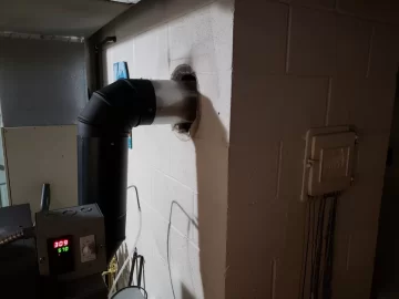

I am getting .1" of draft right now. But even with the fan off, west basement window wide open, and no other ventilation on in the house, if you open the door I get bad smoke spillage. Either the 5.5 with a little ovalization at the bottom, or the horizontal run in my connector pipe, must be the culprit.
I am contemplating lifting the stove another 8" off of the floor, shortening the SS Tee Snout, and running a short section of pipe diagonally. I know Drolet and other stove makers say that a 90° elbow hurts draft.
Good plan
