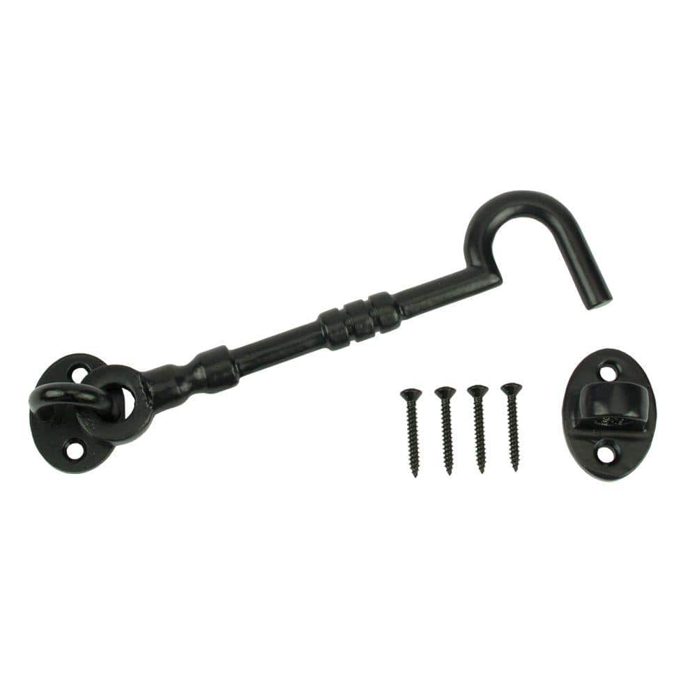

Good idea with the hook! I was just leaving the door open before but people (wife) kept walking by and closing it. I may try this today. Still in the high 30's till monday so it's going to be a couple days before I can really test if stuff changes.
We leave the cat food on the steps, so I had to find a way to keep the door open but to keep the dogs from eating the cat food. This did it.
