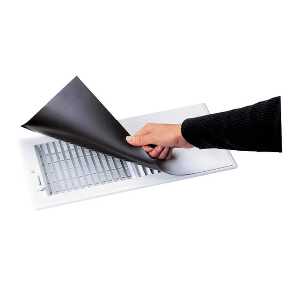

If you are having smoke spillage issues now, can you throw one of these magnetic register covers over the BD right before you open the door to load?
That's a great idea, I was thinking of making something to cover the damper when reloading. I did not think magnetic but I like it.
