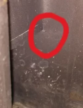

anyone else ever have any cracks form on the front of the tundra?? There were A bunch of us around where i live that put in tundras over the summer and i know of at least three of them that have this problem. Anyone that is running these should look them over very closely.

bottom right corner heat exchanger clean out door (sorry pic is turned 90*) (broken image removed) bottom left corner heat ex clean out
[Hearth.com] Everything Drolet Tundra - Heatmax...
bottom left corner main loading door (glass door) (broken image removed) bottom right corner loading door. first time trying to post pics so sorry if they suck plus there from my flip phone wish i could do better
So this crack is on the heat exchanger clean out door itself or on the body of the HE?

there on the sheet of flat steel that makes up the whole front of the stove, where the clean out and loading door are cut into

maybe this will help visualize whats goin on a little bit better.
Yep, sure does, thanks! And keep us posted...

Will be interesting to see what SBI says about those cracks. If it is indeed the outer shell like Wisneaky says, they may just simply say it's not a big deal and that's that.
i know the cracks on the bottom around my loading door are a cause for alarm, only reason i noticed them the other day was because i went down stairs with the lights off and could see the orange glow of the fire comeing threw from the fire inside the box. my feeling is SBI may have been shipped a bad batch of steel that can take to hot and cold cycles of the fire and is cracking rather that flexing because steel always expands and contracts between heating and cooling cycles. just my $.02
