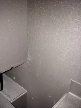

I came home and checked and I've got three.
Correction #2. I've got four cracks. I looked again and found that a crack is going horizontally through the weld, making a continuation of the horizontal seam between the different metal pieces:
[Hearth.com] Everything Drolet Tundra - Heatmax...
Then I looked some more at the big crack I have on the right bottom of the door, you can see the weld pulling off at the top/right of the weld below:
Here are some pictures from inside looking out the door. The crack comes in, around the weld, and trails off to the left. Hard to get good shots without being able to stand inside the furnace, so I have three pictures...
[Hearth.com] Everything Drolet Tundra - Heatmax... [Hearth.com] Everything Drolet Tundra - Heatmax... [Hearth.com] Everything Drolet Tundra - Heatmax...
I did start a fire tonight, and at least I don't see daylight through my cracks like BPwelding indicated he has.
