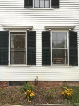

Hello,
From looking at the attached photo do you think a direct vent on a Harman XXV can go between the windows about 6 feet from the oil vent? Please share your knowledge. Sorry I don't have dementions. I am purchasing this house.

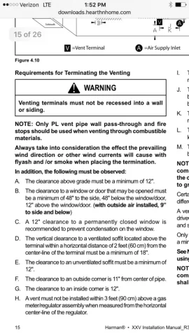

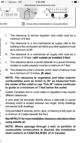

From looking at the Manuel - I can be 9 inches from the windows and 6 feet from the oil fill. Does this seem correct? THIS IS WITH OUTSIDE AIR VENT INSTALLED.
I have attached a few photos from the manual.

6 feet - doesn't matter if you have an OAK or not. The OAK install only comes in play when they are worried about exhaust being sucked back into the house (with an OAK you shouldn't create negative pressure in house so it pulls air from outside), or the OAK sucking up the exhaust from something else and sending it thru either the fire (bad for fumes) or thru the air coming out the heat tubes (bad for occupants breathing). The service supply is a completely different animal - probably worried about potential of sparks coming out the exhaust while the oil tank is being filled - could go boom. Unlikely? Perhaps. But if the wind is right (or wrong as the case may be), the stove malfunctions, and/or Aquarius is in the Second House, it could happen.

Image 8978.png under paragraph B says it all for windows clearance, indeed with OAK it appears they are allowing 9" below and to the side of a workable window.
Looks like I will be good to go with the OAK. Thanks for your responses!

Bogie, heating oil does burn and burn well but you won't get a BOOM like gas. It is a slow burning fuel basically diesel fuel.
As long as you are able to meet clearances within the manual you'll be fine. Manual specs are the go to. I had some windows to deal with on venting but they are easily met as long as you think and out smart the window openings.
I assume the OP wants to come out below the windows with a straight shot since they cited a direct vent scenario. Things can be tight but as long as clearances are met then it would be covered. There are also threads here about getting smart with the windows like making them inoperable but easily undone for when the stove would not be running and windows open might be wanted.
I would suggest you ask the local building inspector for the town the house is located in. He'll be the one that gives the final approval for the permitting and inspection. Show him/her the copies of the manuals pages you posted and the picture of the house where you want to install it.
