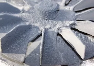

Check this out, Exhaust Fan blades after about 10 bags of pellets, (clean out tee had as much soot as I would see after a ton of pellets)
I got curious after reading the post (black glass on pellet stove) and an other thread were macman and Mike were talking about coating the exhaust blades with a graphite type spray.
Anyway this was after about 10 bags of pellets running on settings 1/2 2/3 with bottom 3 buttons at 5/4/1 on a fully cleaned stove and pipes and these blades in October,
Stove pulls a good flame is only on its 4 ton of pellets I do not believe there are any gasket leaks.
Thinking I may need to change the low are setting to 5? for 5/5/1 lower 3 button setting? or maybe lower 5/3/1 to keep ash and soot out of pipes and in stove?
Stove pulls its own good natural draft, (power went out yesterday and still had a good flame and no smoke entered the home)
Maybe the combination of a strong draft and factory low air setting is actually pulling top much ash and soot out?
Any ideas?

looks normal to me.
all fly ash passes threw the blower so you are going to get some attached to the blades.
cant tell but if it is real black then you have an air problem but normal gray is just fine
It is black ash pic is not correct color sorry it was the only pic I could post , it is black as coal.
(broken image removed)
this is a dirty blower but the build up and color is normal
if you have black then you have lack of combustion air.
start from the beginning and clean and check everything
