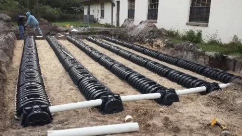

So my spectic system is what they call an "alternative system" Rather than perforated pipe and gravel, the leach field is composed of these "Quick4" chambers which are basically a plastic half dome, open on the bottom that are simply placed in a sand lined trench and back filled.
Looks something like this( not my house):
My septic guy (not the outfit that installed our system - that was done by the PO with another excavating company) says that these alternative systems where really popular in the 90's/2000's and in the last few years they have been doing a lot of replacements of systems failing at less than 10 years old. He says that without the traditional gravel bed the domes are filling up with sand and failing early. they are now abandoning this technology and recommending only the traditional gravel bed install.
My system (2008 install) is still functioning and my guy recommended that I get it pumped every year religiously and try to conserve water to keep my daily use under half of the system design flow to reduce stress on the field and avoid a costly failure.
