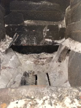

Do you have any idea where I can find the steel liners for a coal bear? All of the plates in the stove that I found are burnt out pretty bad.
View attachment 286072 View attachment 286073 View attachment 286074
This was just discussed in the Fisher Forum.
You will be better off making them from steel plate and cutting your own slots.
