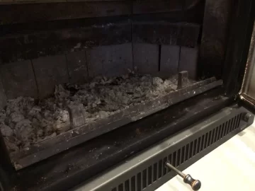

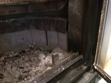

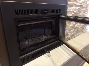

Here is the pics

You have devised a good plan, as simple as can be. Fire it up!
