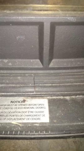

Good evening, Just got done building my fist fire of the season in my Harman Oakwood and noticed a small vertical crack on the edge just below the door. I'm assuming it happened when I pulled it out to change the combustion box last weekend but I'm not sure. Im guessing this just amounts to cosmetic damage but thought I'd check with you all to see if anyone thinks it could be a problem now or in the future.

Does this crack continue inside the stove? Not sure how you would have caused this. What is the warranty on castings for this stove?
It doesn't look like it goes into the stove but I wont know for sure until tomorrow when my fire is out and stove cools down. I'm not sure I have any warranty due to the fact the stove came with the house I purchased. I might check with the local Harman dealer. I believe the stove is only three years old.
