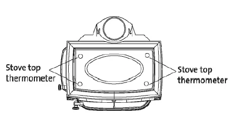

1. My question is whether it matters where I take the surface temperature. Should it be on the top middle? Or am I just searching for the hottest surface of the wood stove and keeping that just below their max recommended temps? The reason I ask is that at least for a small fire, to the touch, the stove hasn't felt uniformly hot.

Break-in temps are stove top temps, not the catalyst. There used to be this diagram for the thermometer placement in the F500 manual. Seems like it was forgotten.
The catalyst would be too hot if it got over 1500º for more than a short time.
