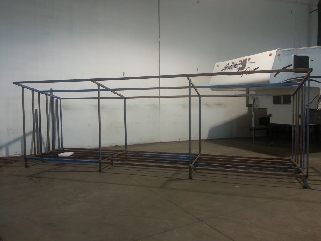

After hours of cutting, welding and grinding the frame is complete, going to pick up some paint and roofing tins today to finish it all up. Then it’s time to unbolt the sections and move it to its home where it can hold a little over 4 cords.
She’s 21’ long, 5’ deep and 6’ tall at the front. The “rails” on which the wood stacks on are 16” apart and have a 6” gap between them for air flow. All made from 1”x2” tube that I got a long time ago for free, could probably make 3-4 more of these with as much of this material I have left. Moving should be easy with 3 guys as the sides, roof and bottom are separate pieces and no one piece is all that heavy.
I will post a picture when I get her moved in, I’ve got the bed all made for her with 6” of bark on top of weed barrier in the best spot I've got for sun and wind.

That's pretty cool. How much does one of those sections weigh, anyway?

The bottom section should weight the most and 2 guys can pick it up pretty easy, i'm guessing around 150 lbs but I can toss the whole thing in the shipping scale to see.

a small dent in a 30 lb spool. employer provide electrical juice, 10 bucks in bolts, 25 in paint/materials, 10 bucks in flap disk's.

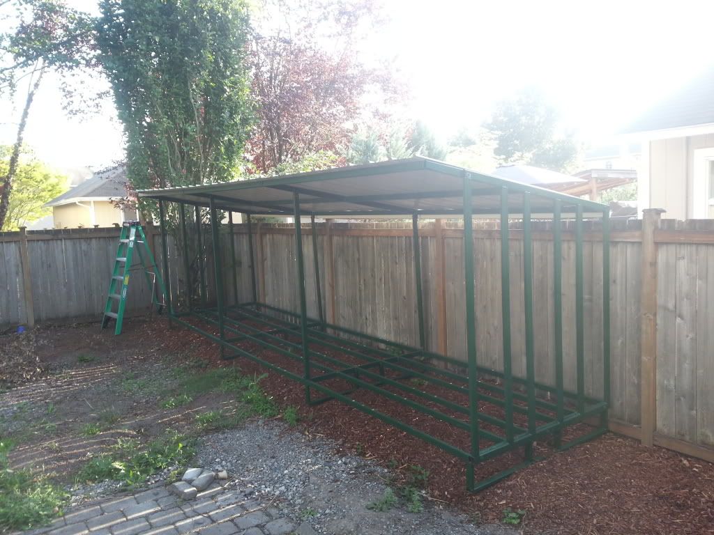

Suggestion: you may want to put some treated boards or bricks or patio pavers under it , to spread the load so that it doesn't sink into the ground.

yeah, it's got 4 pieces of 1x2 on the bottom each 5' long, I don't think it will sink too far but that's why I built it with a 8" air gap under it, hopefully it doesn't sink too far. down side if it does it will once it's loaded with wood. if she's loaded with 4 cords of fir that would be about 12,000 lbs over 480 sq/in which is 25 psi. that's the same as a car/small truck or horse. math isn't my strong suit so feel free to correct.

maybe just stick a cinder block cap or flat 4" thick stone under each leg when you install it....that'd be as good as anything to keep it from sinking..
