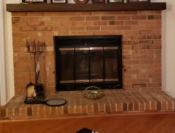

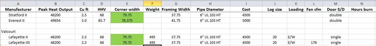

I am developing my list of ZC fireplaces, based on being able to fit in the corner location I have to use where the old one is. Need to consider depth also. Stoves are more efficient, and cheaper, haven't ruled one out but I just don't like the look personally, nor does the SO. Most of these ZC are 66-74% HHV, not a big deal, but will come down to ease of use, loading and burn times. I probably will add a few more filters and labels. I am at least a year away from doing this, the area will have to be demoed, and changing to a stone/brick veneer from the real bricks which are halfway up the wall. Think i don't want to add another 1000# to the floor if i don't have to, and won't be able to match the brick anyways. I know i want the gravity air vents. I've got a 4-season room open to the house that has a PTAC w/ heat pump in it. Something i have to consider, as the room pours cold air into the house. This is an expensive project, since the ZC fireplaces are all 4500-6500 by themselves. My max corner width is only 88", eliminates a lot of manufacturers. But Osburn/Valcourt, Astria, PE, Hearthstone and Supreme are what i am looking at now.

There are other factors to consider: fan noise, heat take off, remote blower, square firebox, service and parts. Of these, as a general rule I am biased toward a fireplace or stove that can load N/S. Many shallow units are only E/W loaders which reduces the full load capacity.

Thank you! I feel a spreadsheet coming on, lol.
Definitely agree with @begreen. I am going to start cutting to 12" length for N/S loading the new Strattford II in the northwoods. It heats pretty well, but isn't an "easy breather" like the NC30 at home and doesn't like softwood (pine) E/W.
