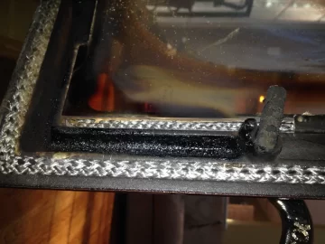

Glass has been getting dirty lately, but mostly on door latch side. Thanks to all of you, I know about the dollar bill test. As expected, failed by the door latch.
Rope gasket looks fine, however. Is it possible to tighten the door latch on the Jotul 550 insert?
I can't find it now but seem to recall this latch as being adjustable. How does the gasket look in that area?
Gasket looks good to my amateur eye. Is why I was thinking the latch just needs to be tightened, if possible...

You Cant get the Handle off with out cutting it if i remember right. Is the gasket behind the glass still in the right place? from the pic the door gasket looks ok it may be a little worn along the top.

The gasket looks the same all the way around and seems to be in pretty good shape. Only failed dollar bill test by the latch which is why I thought that could be the issue. Don't think it's the glass only because it failed dollar bill test, but I will check that out too.

Before I start cutting handles off I'm going to a new and possibly larger gasket. Nothing wrong with your handle I'm guessing and replacing won't do any good. rk can you pull the gasket in the problem area and fluff or turn the gasket to build it up in that part?

Took the door off to clean the glass. Figured I would take glass off and check the gasket, seems like I had a small leak as discussed earlier in this thread. Rope gasket seems kind of shot, and it pulled right out. Should it? Figure I might as well replace with new.
