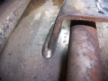

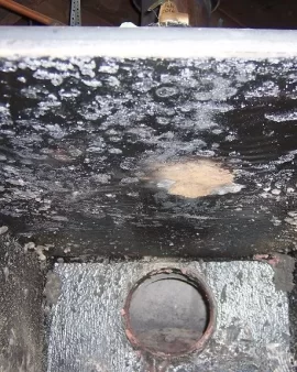

Early Sep 2016, I noticed a leak in the inner water jacket.
I cut an opening in the outer water jacket, then removed a section of the top and side of the inner water jacket. As the photo shows, the inner top metal is barely the thickness of a penny; the sidewalls are thin also. The outer water jacket measures the advertised 6mm. Not sure what material they used for the inner water jacket.
I can get a replacement Eko for $3400 delivered from New Horizon (they reduced the regular price as a result of the failure).
Over the past seven years, the Eko had numerous annoying design flaws (most of which I corrected). Replacement parts did not fit without an extreme amount of modification.

The penny pic, it almost looks like the steel wore from the inside of the firebox, from the waviness - if I'm seeing right. Are/were you running storage? Kind of curious what a similar cross section at the point of the leaking would look like. What part of the firebox was the actual leak in? Or could you tell exactly?
Yes, I have 300 gallons of storage; I would like more but simply no space for it.
The leak occurred below the weld of one stay between the water jackets.
Even when new, I noticed the water jacket on the top inside sounded "tinny".
Thickness near the leak was similar.
I noticed the waviness also...maybe a recycled Russian artillery piece?

Odd that the steel is wavy, certainly not an ASME product :) The leak wasn't due to the wavy steel, or a thin spot, but under a weld?
