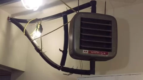

I hooked this Modine up so the return goes thru it before going back out to the boiler. The fan is just hooked up to plug in when I want to get heat in the garage/shop. The water is about 155. It is not really throwing as much heat as I remember from years ago in the basement.

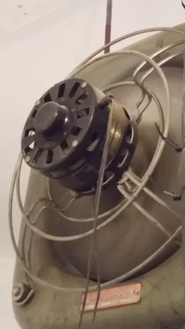

Question is: can I put a rheostat on this kind of motor without doing any harm to it? I feel like the fan is blowing so hard it is not transferring heat, is that possible?

A variac will work to slow the rotation although that isn't the way variable speed motors are usually controlled .

A normal variable speed motor is built specifically for variable speed with electronics that are compatible with a matching control box with a bunch of complicated electronics that allows it to vary it's speed while having little effect on torque.

Since the water temp is only 155 instead of 180-ish, the heat output of the Modine is going to be less than it was before. With the fan running it will feel like a cool wind chill instead of a blast of heat. Slowing the fan speed will reduce the wind chill effect, but you will still be getting the same amount of BTU's out of it, just less than before.
Don't use a "rheostat" or dimmer knob. These basically just reduce the voltage and will make the motor hum and buzz and possibly shorten it's life. You need a (variable) electronic speed control. It will turn itself on & off rapidly, basically "chopping" the 60 hz a/c to a lower frequency. 50% would be 30 hz, half speed & about half the airflow.
