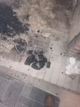

I called a buddy who is building a cabin and he said he wanted the stove so I disconnected the liner and pulled it out to find that the liner is about 4 ft too long and when installed the installers evidently connected the liner then put the stove in the fireplace causing the liner to make a an N shape about 3 ft up the chimney. I had noticed a tight spot when cleaning (I use the rope dropped down tied to brush and pull the brush down to clean) but never would have known it was that jacked up. Once I straightened out the liner and gave it a shake all this fell out and I was able to get the liner clean.

Throw that stove back in there dude. Don't give up. Get the liner fixed and enjoy a properly installed wood stove.
