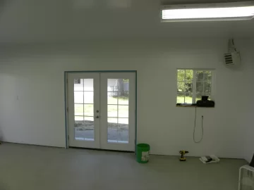

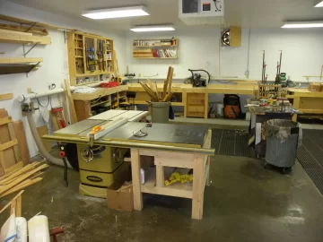

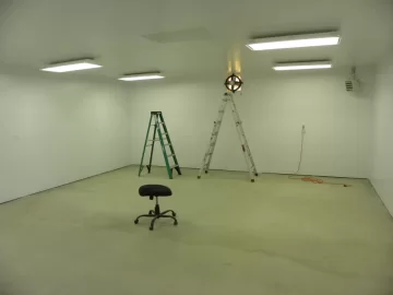

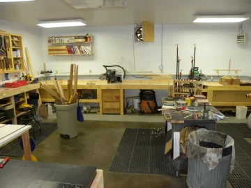

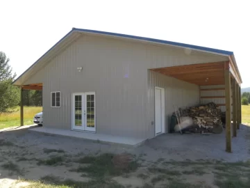

Still thinking about Big Shop Air Filter. We have one in Wife's Happy Place. We sealed the floor before anything went inside. That makes cleanup a Joy! Glad I put in two 5k Electric Heaters for Shop. Pellet stove not as clean as I hoped.
