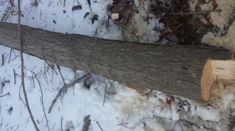

I cut down that standing dead ash tree I asked you guys to id. It's the first tree of any size I have cut down. A few lessons learned. It ended up getting hung up in another tree so I had to cut it down too. Can you guys Id it. I haven't started bucking it yet so just this one picture. Thanks

Ugh, leaners are dangerous. Glad it worked out OK.
Looks like a hard maple from where I sit.
pen
Ok hard maple sounds good to me.
We'll see what others say.
At that size, I've made mistakes before with maples. I'm leaning towards hard maple but have had some softs that surprise me, until I put the saw in them to buck it up and have it chew through much faster than it does on hard maple. Or even hefting a round, soft maple is lighter to lift in comparison.
That's my knee jerk reaction, we'll see what others chime in with.
Stay safe.
pen
leaves on the ground look pretty maple-ish.

Best guess I say maple. Be really careful when freeing a leaner by cutting it's partner. Scary!!

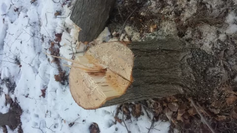

I think what happened was i didn't cut the face notch big enough. The notch was closed when it got hung up. So I think if I would have had a bigger notch it would have came all the way down. I don't know if I'm explaining that right.

The tree pictured looks a lot like the red maple I've been cutting here.

bark doesn't look like the red maples here, nor the norway maples, but the wood kinda does.

That tree looks like the Red Maples around here, but Sugar maples are very similar.
Looks like sugar maple to me, too.
Looks like you had a shallow notch, too high of a backcut, it didn't fall so you came in with a deeper front cut into the notch. Lucky not to wreck your bar, right?
