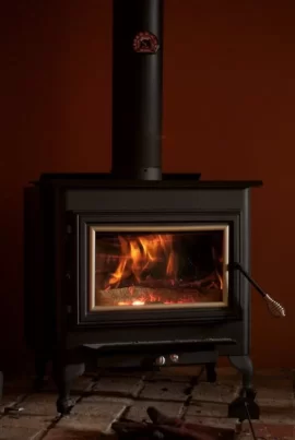

Here's a pic of the stove cruising at 550+-, 45min to and 1hr after reload. If you look close the mag thermo is at 300.

Looks great I think those are very good stoves for the $$... Now you can relax and enjoy the heat...
Ray
great picture, enjoy!
Nice! I just picked one up this week. I hope to install soon.

About 18" up from the flue collar. I don't let it much higher than that and sometimes lower depends on the load. The past two weeks I have spent alot of time on the couch reading and watching it burn. I still haven't perfected it yet but I know it will come with time. Sometimes she likes it hot around 600 stovetop so I let her cruise there if she wants. It's a fun learning curve. My wood for next year will be more consistant also since it's all been cut split and stacked already. This year I had to buy a cord in early Oct and it could be better. Also so far my glass is really staying clean.
LOVE THE PICTURE, MIKE YOU SHOULD BUY THIS PICTURE AND PUT IT ON YOUR WEBSITE......
ha ha. I'd be willing to trade the rights for maybe a ...........nc-30 :-P LOL
