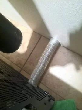

I know I am still very new to the pellet world but in the first 2 weeks of using without and then with an OAK, homemade in my case, the difference is incredible. Mine is simply a 3" flexible dryer vent pipe running outside. I can put my hand on it from outside and feel the air being drawn into it so I know it is working well. Heating a 1500 square foot garage, the thermostat keeps it on a nice 60 degrees easily.

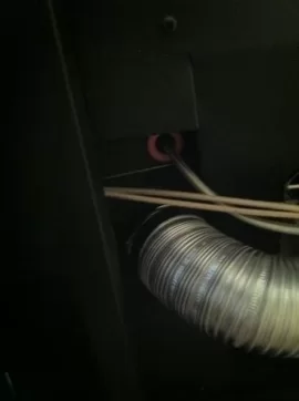

I knew two days in I needed one. I hadn't even really thought about it when installing, even though I read and understood the manual... I thought. I was to the point of stuffing a towel at my front door because so much air was being sucked in. I also couldn't get above 71-72 in our living room on medium overnight, even on mild nights.

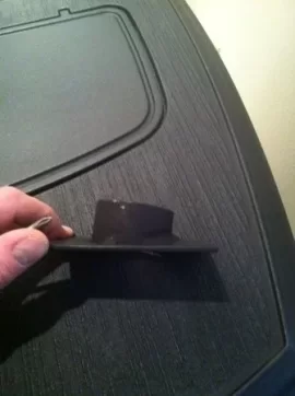

Like others, I questioned the Santa Fe airbox design but I think its working great at this point. The air tube is cold too, so I know its drawing, and from outside I can hear it quite well.
I made my own flange and bought some 2" flex from Woodlands, and installed on Christmas Day. I now hit 74 downstairs overnight and have the feed throttled down to minimum, and no more wind tunnel through my living room and the wife "mentioning" the cold drafts.
The real kicker for me was when someone here suggested open a window close to the unit, so I did. I opened it all the way up. I felt the cooler air but not significant, then I closed down to about 1inch open, it damn near howled and the air rushing in made up my mind! Also at one point my wife kicked the drier on and I heard the fan change sounds.
Just a couple pics showing how easy/simple they can be.
