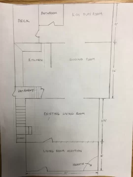

Can you provide more details on the layout? A diagram would help. You say it's open downstairs...so there's just a couple bedrooms upstairs, for 1750, total? Will the stove be centrally located in the downstairs? What about in relation to the stairway? The Rangeley is a partially-jacketed stove with a blower so it should work better if you have to move heated air to rooms that are further from the stove. The Oslo is more a radiant design, heating things within line of site better. In practice both designs end up being blends of radiant and convective heat, though...
This is a rough sketch I threw together... and sorry with the addition it'll be about 1600 sq ft. Not tremendously open floor plan but the heat doesn't have to travel around too many walls on the first floor. 3 bedrooms and a bathroom upstairs. As planned right now the stove will be at the corner of the house.

That's going to be a long way for the heat to travel to get to the other end of the house. Looks like the dining room or living room would be a better location from a heating perspective. As designed maybe a small stove as an area heater would be better.
In my opinion its always best to centralize the stove so the flue exits near the roof ridge and becomes the heart in the house.

Thanks for the replies guys. I would love to locate the the stove in the central part of the house but that would put it in the dining room and we really want the stove and fireplace in the living room. I've been searching for solutions on my setup and not coming up with many other ideas.
I believe the Oslo is my choice. I also have ceiling fans that can help move air. FFjake, thanks for the response on the other questions. I believe The deal is about as good as it's going to get. I'll kick myself if I'm wrong but... should an unused floor model be cheaper than having the stove shop dealer ship out a new one?
Can it go in the existing living room instead? If not, skip the door to the new room and make the opening to the existing living room as large as possible.
BG, I'm sorry for not explaining myself. Yes the new living room addition will be very open almostbthat entire 19 feet opening will all be open... I should have just drew it that way. It will basically be one big living room almost 20x20
OK, that makes a major difference. With a convective stove and maybe another fan for assistance this could work, especially if the opening between the living room and dining room is large. It may take a fan in the kids area on the floor, blowing toward the stove room to even out the heat.
