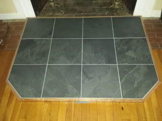

I am starting my hearth for the new Keystone. It is a simple affair, scrap redwood planks to give it the height and the usual hardiboard and topped with slate tiles. I was going to rabbet the edges of the wood, seal them and use that as my edge trim [or, border some might call it]. Then I thought, wait, that trim would be flammable. So I need to use something else. I thought about just leaving a half-inch space around the edges so I could use grout, and I may still do so [run the grout at about a 45-deg angle from the wood up to the edge of the tile]. Any other ideas out there? I don't want to use shiny aluminum or anything like that.
The wood trim with a rabbit will be just fine unless your hearth is made to the bare minimum. I would highly suggest making it larger than the minimum, then the wood trim isn't an issue at all.
What are the hearth requirements of the stove? As long as it only needs ember protection and that wood edge is beyond the minimum hearth size it wont matter.
I put tiger maple on the edges of my Keystone hearthpad. Not real worried about it...

Thanks for the responses. I left out an important caveat: the hearth is raised enough to give me clearance to the floor. However, the front edge of the hearth will be about the distance of the length of the stove legs. In other words, the stove will sit near the edge of the hearth. That means less than 12" clearance. It may still be enough, in reality, I don't know how hot that little rabbet would get. I have the stove set up on a dolly at the height of the eventual permanent hearth so I could do a test installation of the stovepipe. I may open up the house and do a few break-in fires and see how much heat actually makes it from the bottom of the stove to the areas of the hearth.

I didn't mess with plywood. That was ok for my pellet stove with low external temps. I didn't want it that thick and I really didn't want any wood in it (except for the trim) for a stove that might actually get hot, especially below. So I welded up a solid frame of 1" angle iron. Screwed the trim to that from the inside.
