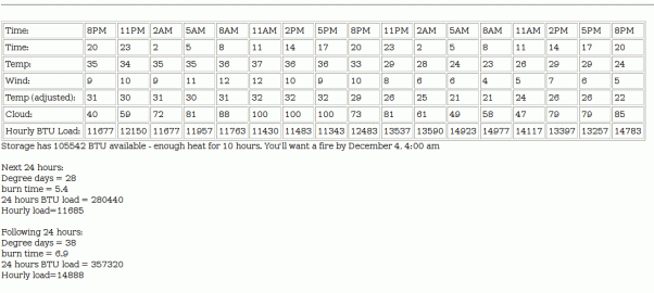

I've updated my private version so that it checks the amount of heat in storage. It then looks at the heat loss and figures out how long before the storage runs out, and tells you how long before you need to build a fire. Unfortunately I can't add that feature for the public version, although I could provide a place to put in your own storage numbers.....

I've got mine tied into a calculation of heat left in storage. Yesterday morning it said that I'd run out of heat by 6:00 this morning if I didn't build a fire. I skipped the fire and ran out at about 5:00 this morning. Pretty close for a 20 hour look-ahead based on a weather forecast. That's what I really wanted - a tool to tell me if I can skip, and to help me figure out how long of a fire I should plan.
