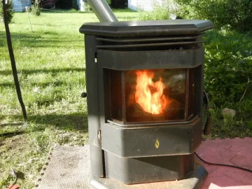

My old Whit has been good to me for another heating season! So good, I have treated the stove with new firebrick. Ahhhh, looks brand new, but I notice that there is a gap, and the flame is going in. Is this a problem, or have I not took notice to this before. My old brick had a gap, from use, but I can't say if flame went in.

I was able to return my firebrick. The clerk open several boxes, and the brick was all the same. Wrong size. The owner came to talk with me because I wanted a refund. He didn't really understand and said he he has never heard of this being a problem and the flame shouldn't be to much of a problem. I showed him a video I took, and he said he could either file the brick to fit. I told him the problem is, the hole is too big all ready. BTW about a quarter inch, each side. The measurement of the brick itself was off as well. When installed it hit the sides of the left and right baffles, and really didn't fit the back like it should. He advised, that I really should have a service call to find out way my stove is pulling air in like that. I said with old brick in problem solved.
He said he would find me brick, it just might take some time. I said not a problem, but wanted a refund til that time came. He was amazed that the Whit is still running and assured me parts are going to be my big problem soon.

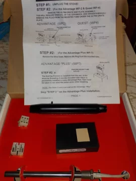

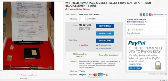

Actually Whitfield made an igniter upgrade kit for the Advantage and Quest pellet stoves. Some weeks ago there was one for sale on eBay.
The add is removed now, so it must have been sold, but luckily I took some screen shots, so you can study the details... from the instructions we can see that both the Advantage and Quest stoves should be prepared for installation of the igniter tube:
[Hearth.com] Firebrick replaced [Hearth.com] Firebrick replaced [Hearth.com] Firebrick replaced
I know the fire pot had the igniter hole in the stove(Quest) But being a used stove did not know if the pot was original. Thanks for the info.
I just replaced the igniter in my Quest. Previous one lasted about 4 years. 3-5000 starts is how they are rated. The kit(above) was factory installed before delivery.
