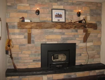

I got a good deal on this stone, so I decided to start another project. I am very pleased with the way it turned out. Enjoy!

Very nice! I like the all of it. The black powder, the mantel..it all looks good. Well done.
edit. Just noticed the tomahawk on the mantel and the lamps..sweet

Thanks, it was a long process. The pictures make the room look kinda skinny, it's actually about 11' wide.

What kind of wood is your mantel? Interesting way to brace it too

I had the mantel made at a local saw mill, it is Red Oak measuring 8"x12"x8' in length. It weighs about 300 lbs. I think!

Well, I watched alot of videos before I started, one company said it could be done either way, as the video showed. I tried a small test area, about 5 stones and I was unable to pull the stones off the wall, and the mesh had zero flex to it. I decided it was a step I could skip and still have a good bond.

It is cultered stone (cement). It was pretty easy to do really, mortaring between the stones was the most difficult part.
