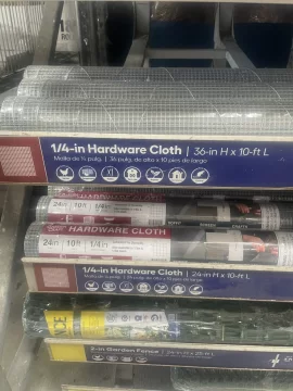

Pic 00 - Hardware Cloth at Lowe’s

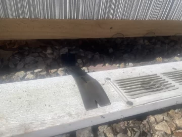

Pic 01 - Larger side entrance

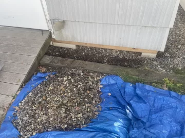

Pic 03 - shovel out stones on a blue tarp

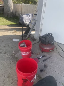

Pic 04 - Tools Compressor pry bar etc.

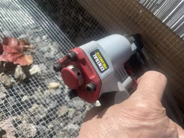

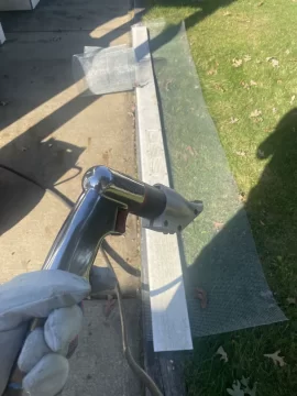

Pic 05 - Cutting hardware cloth with air power shears

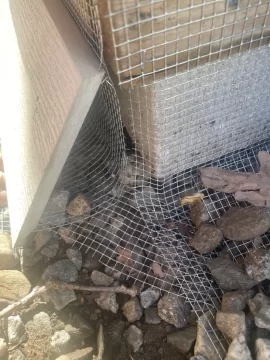

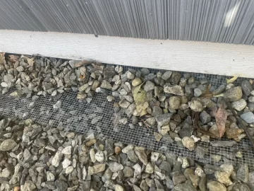

Pic 06 - Bend & Air Staple Hardware Cloth to PT sill board to cover space between cider block and 7” of ground to prevent chipmunk entry

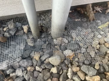

Pic 08 - Using wire cutters - Cut and bend hardware cloth around electric pipes

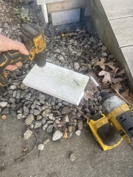

Pic 09 - Drill pilot hole and using galvanized 1-5/8 deck screws to screw composite trim boards back up

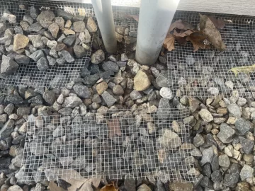

Pic 10 - Cut additional pieces of hardware cloth to cris cross the ground on the corners to prevent hole digging.

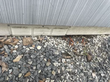

Pic 11 - Shovel stones back
