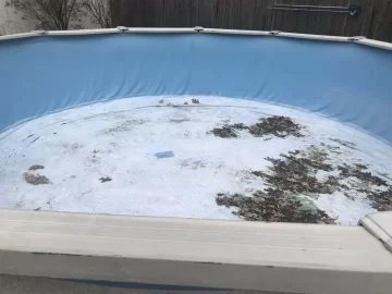

All the water drained out of the 18’ round above ground pool this spring! I have never seen that happen before!
I looked carefully and there was a big tear in the center of the bottom! I carefully patched the tear and found another hole and filled it too a little above the bottom. It all leaked out. I found a few more holes and patched them using some special vinyl patch and vinyl glue and filled the pool again to a little above the bottom. Still no luck. The water seemed to stay in the very bottom but leaked to below the cove around the bottom edge. I could not see anymore holes but the liner being approx 15 years old, is it just maybe KAPUT??
Just by chance the local pool store had 3 Latham Niagara with Prism overlap liners coming in and they also had a bottom pad, coping strips and skimmers coming in! I had received them all in only a week!
The ground and sand under the old liner was good and packed down nicely.
Is it possible for an old liner just croak like that and just not hold water at all anymore?

Pic 1-4 -- Trying to patch the old liner and still would not hold approx 4 inches of water as shown on the stick!
