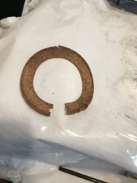

Also that stupid cork filter return gasket tore when tightening it. So I have to replace that with a silicone gasket!

Pic 6 - Torn cork gasket when tightening!

That broken cork gasket gave me one more special fix I really believe will be much better in the long run on the filter return. I cut my own high temp 1/8” filter return ring gaskets from the red-orange sheets and used one outside and one inside the pool along with their white silicone gaskets. The silicone I use is a little more flexible and really makes an excellent seal. Similar to those good old garden hose gaskets but maybe slightly better.

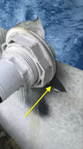

Still had a slight drip leak on the filter return! After 3 hours I finally figured out that piece of duct tape I put in the hole to cover a sharp edge was causing the leak! So that is another thing NOT to do!!
I ended up putting 2 of the white silicone gaskets that came with the filter return on each side and tightened by hand with a little snug with the wrench which is all you need for it to work!

Pic 2 - Filter Return with duct tape thru hole on pool wall. Do Not do this because it can cause it to leak! LOL
